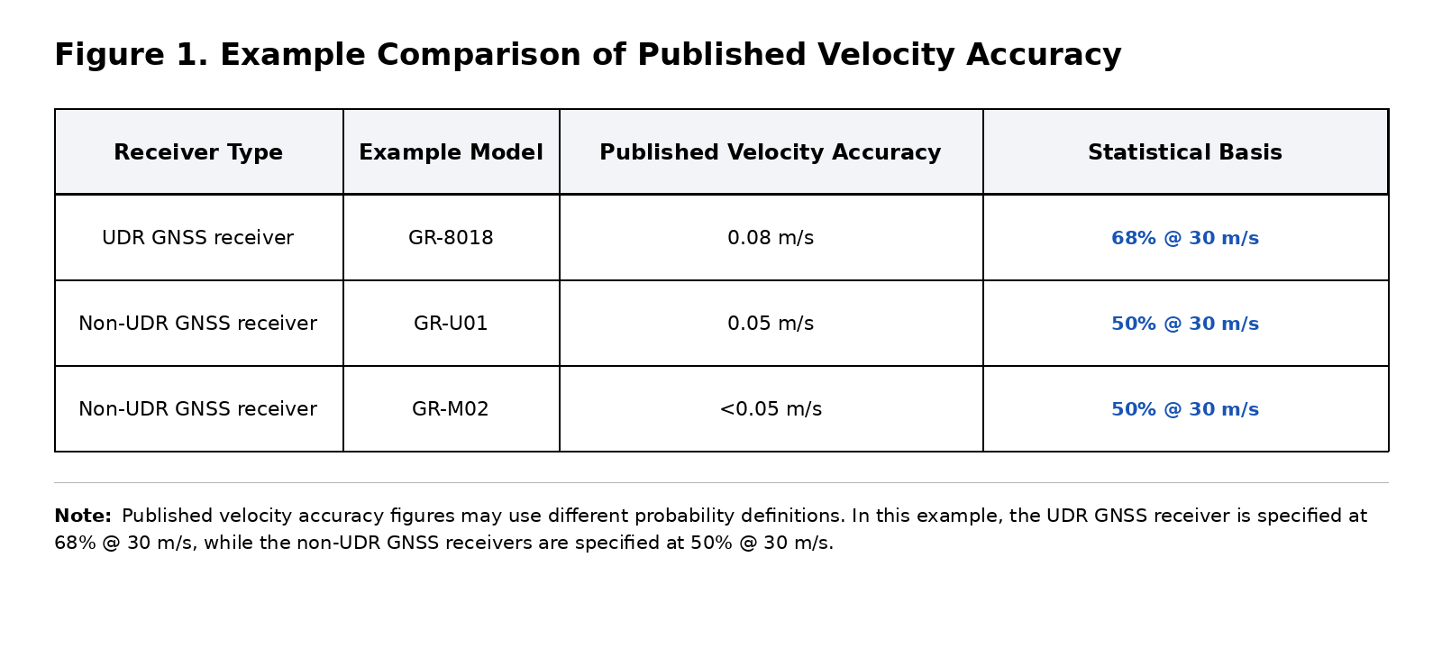

5. Accuracy Figures May Also Be Based on Different Statistical Definitions
Another important factor is that published velocity accuracy figures are not always based on the same statistical confidence level.
For example, one receiver may specify velocity accuracy at 68% probability, while another may use 50% probability. If the probability basis is different, the specification values are not directly equivalent and should not be compared as if they were measured under the same standard.
Therefore, when reviewing a comparison table, it is important to consider not only the value itself, but also the statistical basis behind it.
