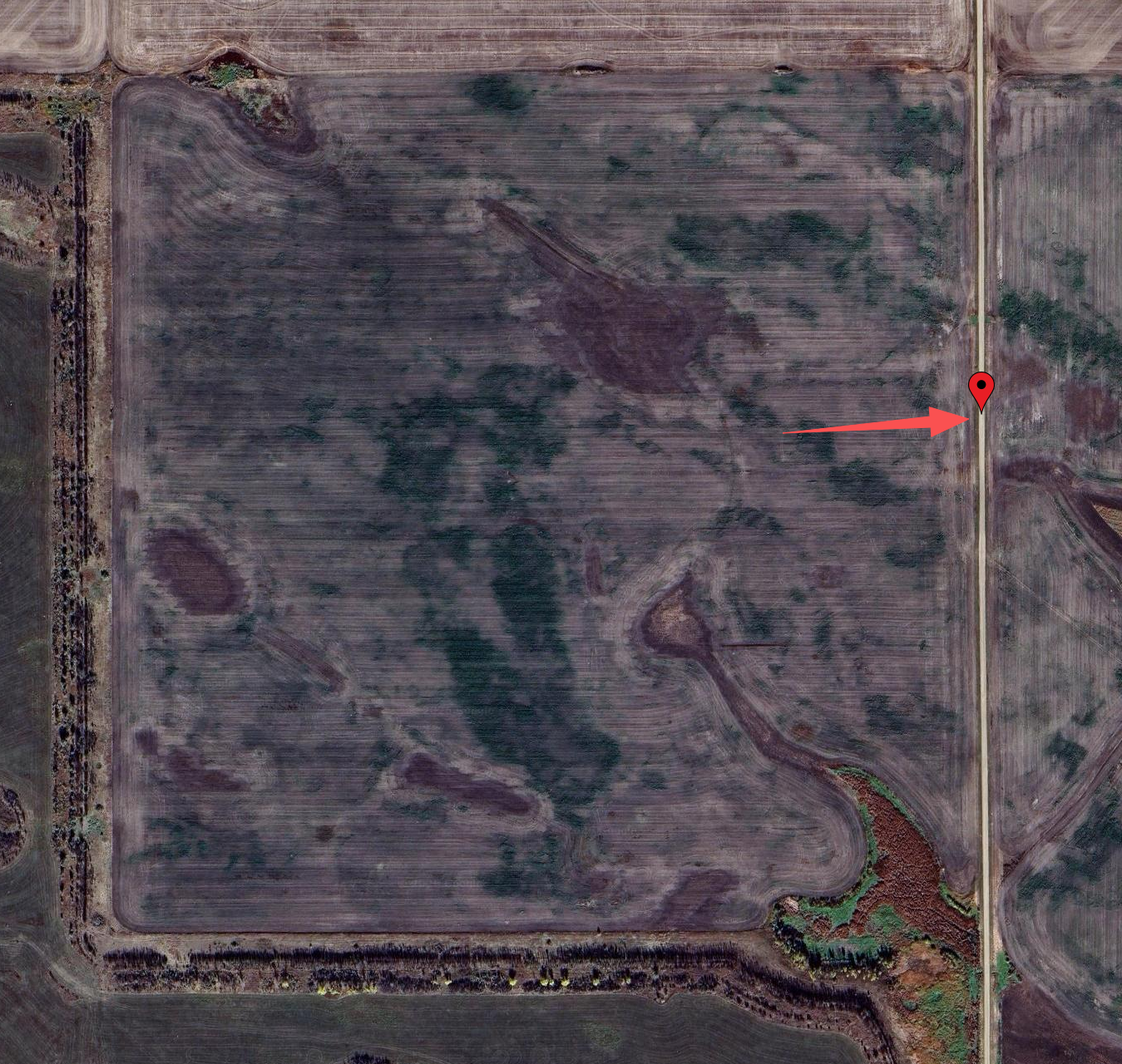

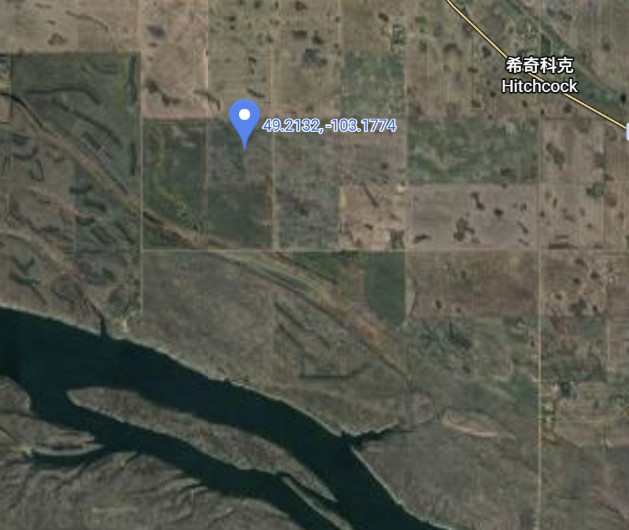

In one recent case, a user in southeastern Saskatchewan, Canada, reported that the displayed position from a GNSS receiver appeared to drift or shift by roughly 10 to 20 meters when compared with a map and another receiver. The test area was near Estevan, Saskatchewan, at an elevation of about 600 meters.
Coordinate near Hitchcock and Estevan Saskatchewan
The reported work area was near Estevan, Saskatchewan, in southern Canada.

The customer-provided test area is in southern Canada, in the southeast part of Saskatchewan. After locating the area on the map, we could see that there were not many clear road features or fixed reference points inside the exact test field. Therefore, the road on the right side of the area was used as a reference point.
Field position reference marker on satellite map
Because the field itself had few clear reference features, the road on the right side was used as the reference.

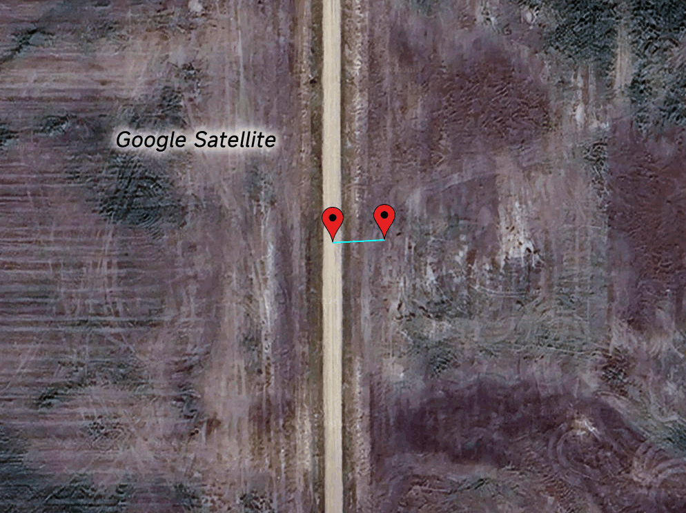

When we zoomed in on this reference area, the same road did not line up perfectly across different maps. Google Satellite, Google Maps, ArcGIS Satellite, OpenStreetMap, and other map sources can all show slightly different offsets.
Google Satellite road reference showing map offset
The same road can appear shifted depending on the map source or imagery layer.
This does not necessarily mean the GNSS receiver is wrong. Satellite imagery is not always captured from directly above the ground. The image may be taken at an angle and then processed into a map layer. This can create projection or orthorectification errors. In our experience, this type of visible map offset can be more noticeable in areas with elevation changes or when comparing features from different imagery sources.

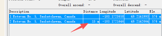

In this example, two points that appear to refer to the same road location on different map layers were measured as being about 15 meters apart.
Two map reference points showing about 15 meters of difference
Two reference points that appear to represent the same road location can be about 15 meters apart.
Important: If two map layers disagree by this much, then comparing a GNSS receiver against only one visual map layer can be misleading.

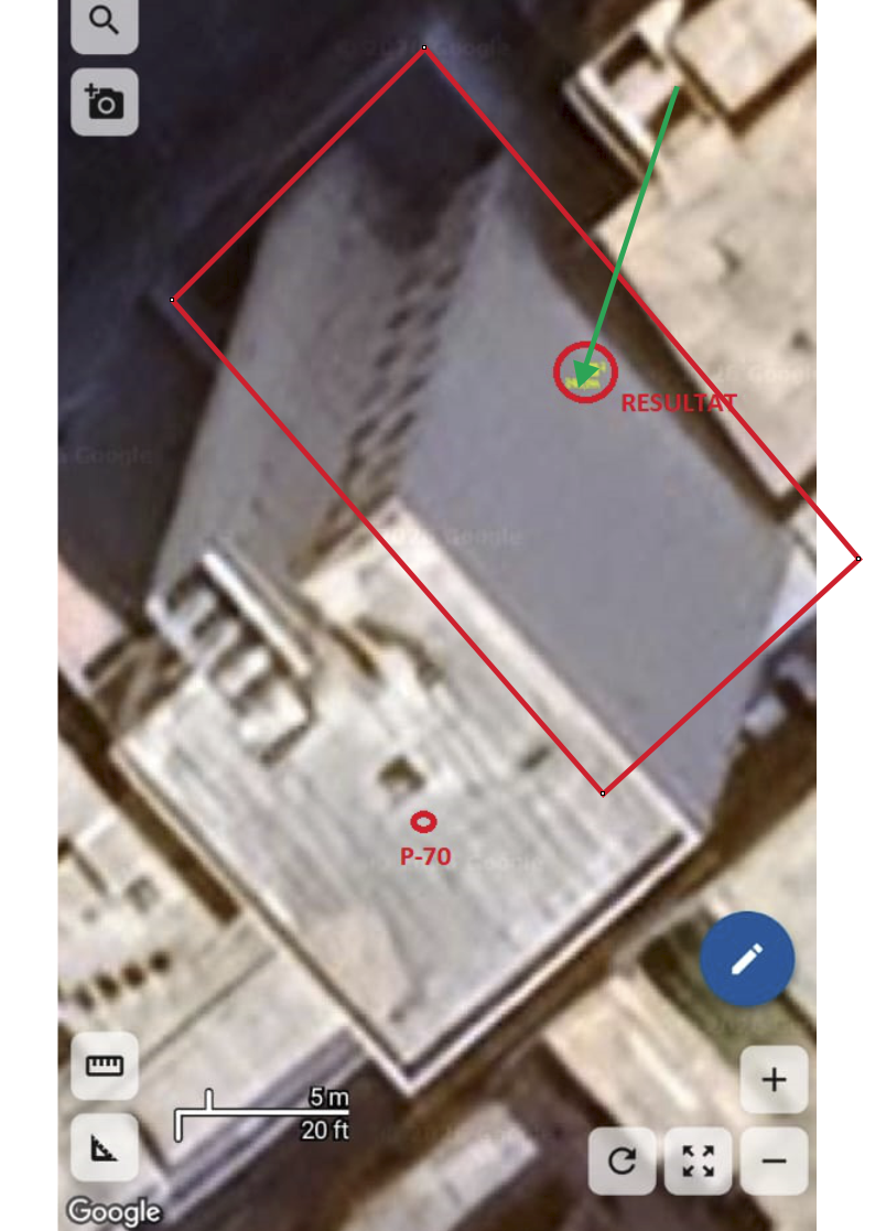

Here is a more intuitive example from a P-70 user. The user tested from the center of a rooftop on a building about 10 stories high. On the satellite image, the reported GNSS point appeared toward the upper-right side of the roof, so the user thought the receiver was wrong.
However, after marking the approximate base of the building, the GNSS result made sense. The roof image was shifted because of the viewing angle of the satellite image. The GNSS receiver was reporting the real ground-referenced position, while the rooftop in the image was visually displaced.
Rooftop example showing projection error on satellite imagery
A rooftop may appear shifted on satellite imagery because the image was not captured from directly overhead.
This is a classic map projection or imagery offset problem. The higher the object or terrain feature is, the easier it is to see this effect.

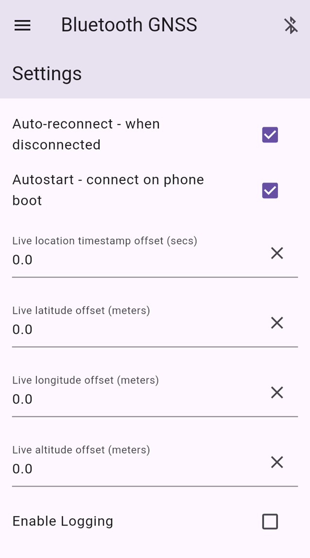

If RTK is not available and the application is using an Android device with Bluetooth GNSS, users can also apply a manual offset in the Bluetooth GNSS app. This can be useful when the goal is to make the displayed live position line up with a known local reference point on a specific map.
The practical method is:
  1. Place the receiver at a known reference point.
  2. Open the same map layer that will be used during operation.
  3. Compare the live GNSS position with the known reference point on that map.
  4. Apply latitude and longitude offsets in the Bluetooth GNSS app until the displayed position lines up with the reference point.
  5. Begin moving only after the offset is set.
This does not make the map absolutely correct. It simply aligns the live position to the selected map layer for that working area.
Bluetooth GNSS app offset settings
The Bluetooth GNSS app allows latitude, longitude, altitude, and timestamp offsets to be entered manually.
