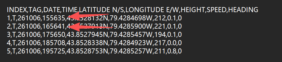

In the supplied one-hour interval sample, the first two records are 1 hour and 6 seconds apart, indicating that the device obtained that particular fix approximately 6 seconds after waking. This is an example rather than a guaranteed acquisition time.
