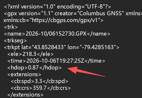

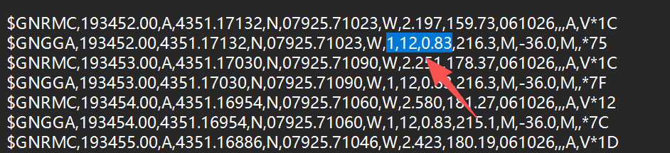

Do any of the formats (CSV, NMEA, GPX, or FUSION) record HDOP, number of satellites, or fix type? Sample files for each format would help a lot.
Quote from GPSWebShop Official on October 6, 2026, 9:38 pmGPX files include an
hdopvalue. NMEA output uses GNGGA and GNGSA messages, which provide HDOP, the number of satellites, and fix type.The supplied standard CSV and Columbus Fusion CSV samples contain position, altitude, speed, and heading, but do not include HDOP, satellite count, or fix type. Therefore, GPX or NMEA should be used when fix-quality information is required.

GPX example showing
<hdop>0.87</hdop>:
NMEA example showing a GNGGA record; the highlighted fields include satellite count (
12) and HDOP (0.83):

GPX example showing <hdop>0.87</hdop>:
NMEA example showing a GNGGA record; the highlighted fields include satellite count (12) and HDOP (0.83):
