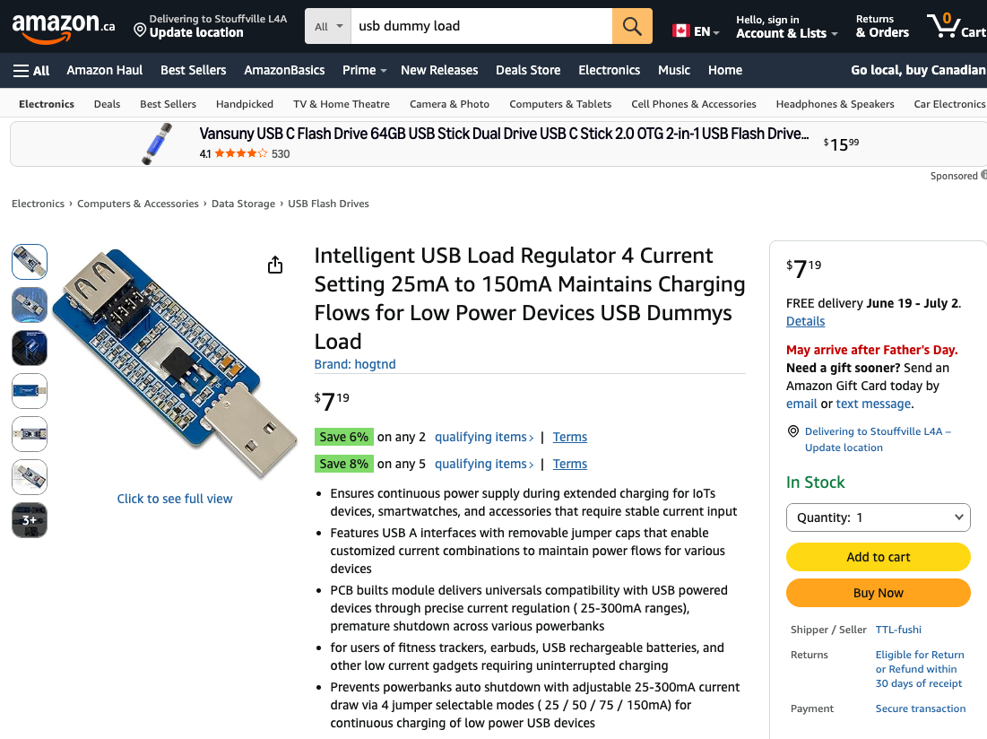

Option 2: Use a USB Dummy Load
If your existing power bank automatically shuts down, a simple and effective solution is to use a USB Dummy Load. (For example:
this usb dummy loader available at Amazon. Please also refer to the screenshot below:)
A dummy load adds a small additional current draw, keeping the total consumption above the power bank’s shutdown threshold.
